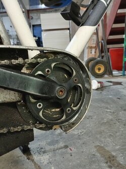

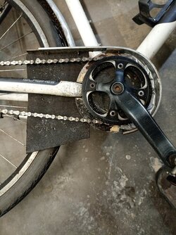

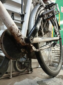

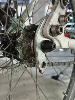

Been experimenting with chain cases on my winter commute bike for a while now and this seems as affective as anything it's open on the outside but gets little or no crud inside it . Over the last three months I've tried it with a simple six speed derailleur setup a single speed and obviously would work with a hub gear too , but only any use with a single chain ring .
It keeps virtually all of the filth off the chain and chain ring/sprockets while eliminating the problem of accessing the chain if it throws it off the chain ring with a derailleur or rear wheel removal problems.
It looks ugly but very effective at reducing wear/cleaning with the single speed it's been easy to monitor chain wear and it needs little adjustment simple to make weighs very little .
I know this approach is not for everyone but if you want a simple long lasting easy to maintain setup its not bad .

I don't think it's particularly ugly. It's rather neat.

How did you attach it to the frame?
I made a hole to match the size of the bottom bracket and removed the b/b trapping it behind that's all really it could be made lighter and neater useing lighter plastic instead of the roofing felt to create a barrier between the chain and rear tyre .

I have found that most of the crud comes from the front wheel spraying directly all over the chain ring and just about all the rest comes from the close proximity of the back tyre as the chain pases by it if you eliminate these 2 things it's amazing how clean the transmission remains even with the filthiest weather.
