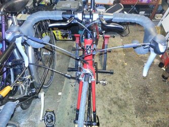

Secondary levers also called top levers are fitted on the top part of drop bars. They simply bolt on and usually do not need to be slid on because the clamp undoes. Once in place you disconnect the brake cable from the brake mechanism but leave it in place at the original lever end. Then slide the outer cable off. You then need to cut the outer cable so that the first length of cable fits between the original brake lever and the new lever. Then thread the inner cable through the outer and through the new lever. Then fit the remaining length of cable between the new lever and the brake before re fitting the inner cable and adjusting. The new lever works by pushing the outer cable. The above probably sounds quite complicated...but it isn't. However you may need to re-tape the handlebars and sometimes the existing brake cables are not long enough to add secondary levers so may need replacing. Secondary levers cost appx £20....and you need to buy them for the right sized handlebar. Picture shows what they look like as fitted to one of my bicycles.
