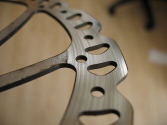

when i tried using tektro brakes with shimano discs, it worked, but was noisier and i could feel some judder. after close inspection i realised that tektro brake pads are wider and rub on rotor legs. switched back to tektro rotor and it certainly works better. shimano rotor wear can be seen in a pic below.
