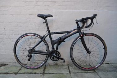

Ha, yes you definitely did mention the idea before I bought the Espresso frame. Ok, some background... before Xmas, I saw cheap Espresso and Jack frames on Ebay - considering the Tern/Dahon issues in play, I thought it wise to buy a spare frame for my Jack (which is an excellent bike BTW) in case the worst happens.
So now I'm tripping over the frame whenever I go into the garage and I'm thinking - can I make a road bike out of this? 4 months later and a load of bike bits are sitting in the house ready to be built up.
The frame
I like the Espresso frame over the jack as it's just laquered alu, I have a 2004 Dahon Presto Lite in the same style and recognised that scuffs are less visible with the bare frame colour. The Jack has this matt black colour, which easily scuffs. As it's Alu, it's pretty light (I'll mention the final bike weight later on in the post).
The kit
To answer some q's:
1) Brakes - I do have long drops on the rear (front brake long drops with the long bolt). The front forks are carbon road forks, so long drops not needed for the front callipers.
2) It has 700c Shimano Road wheels (cheap from Ebay) - 130mm. The frame is 135 dropout, but it easily compresses to 130mm with the QR sqrs. To be honest, the frame seems to sit without the wheel with a 133 dropout distance - so either way - running at 135 would push it out and 130 would compress. Me and the LBS seem to agree that this seems to work ok.
3) The frame is the same medium frame size as my Jack - no problems with reach on the drops (but I am using FSA compact bars).
I've got a cheapish 2012 Tiagra groupset that I sourced from Ebay, long drop brakes for the rear, SDG seatpost and I'm reusing my Dahon SDG saddle from my Presto Lite to maintain the budget. The pedals are detachable MKS Promenade's with PowerGrips - but I may swap these over to clips later on...
As the frame is a MTB frame the front derailleur needs to be a top pull unit, so purchased a Shimano Cyclocross CX60 FD (which is compatible with the Tiagra groupset).
Weight
- With the finished bike, the weight comes in around 10.2Kg. It can go lighter with different components, but I wanted sturdy components and to see how it rode first (i.e. minimal use of carbon). As a comparison, my Jack with commuter bits weighs in around 14.5Kg, so the weight difference is noticeable.
Ride
- It's definitely comfortable - much better than a road bike I owned in the nineties. I suspect that the carbon forks and the hinged frame design have an effect here. It also seems to accelerate faster and need less effort to keep moving than my Jack. From this project, I'm now thinking about changing the wheels on my Jack to a lighter 26" wheelset.
Folding

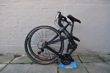

I've fitted the Espresso/Jack bottom bracket stand for sitting the bike when it's folded. Which means it can sit in the garage or train without damaging the big chainring. Additionally, it seems to sit neatly without falling over.

mm- that X10.

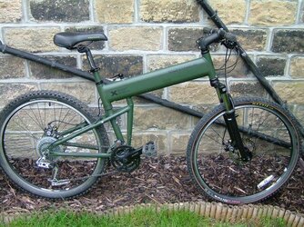

I'm selling a Montague Paratrooper in the classifieds. The cross bar is one piece so you don't get any flexing - rides like a normal bike but with the advantage of being a folder.

Sorry _Jim, I've been on holiday + totally maxed since the PM you sent me and unable to get back to you. I'm glad you got all the bits fitted ok. The bike looks fantastic!
Re the Dahon Stand. C H White can sell you one -> http://s442721994.e-shop.info/
It's hidden away on this page (they have different stands for the D7/D24 variants):
http://s442721994.e-shop.info/shop/...wYlVZdQKizxFjNI9ck2yVHgSZBUX&shop_param=cid=&
How does the FD shift? Are you using the Cyclocross unit I use on mine or did you try another product?

Cheers schocca....yeh I like the 'stealth look' you get with the matt black frame!
The standard d7 stand is now just a bit too short due to the larger chainring......looks like the d24 will be the one I want......thanks for the link.
Went with the same cyclocross FD......seems to shift fine.......been on it a week now and is perfect for using on the train. Had quite a few admirers come and ask me about it too!
