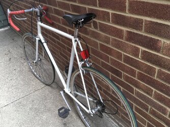

However, my original concern was correct and it's too big for me as the frameset's a Large size and I'm too stretched out. Therefore it'll be listed on here once I've painted it at an intentionally low price (does £20 collected seem low enough?) with those parts included. Should it not shift on here it'll go onto eBay at a more appropriate price. Originally it looked like this and no, I don't have a photo of the correct side:
