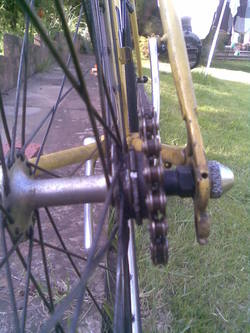

Here is my new toy/project.
Its cost me £7.19 so far, and i have no more to buy for it:laugh: Im picking up a back brake inner and outer tomorrow and an inner tube from a mate(hes giving me them, i am that tight;)) and then it will be built.
Here it is.
Oh, and the bike how it is isnt £7.19 until i put the bar tape on! The only thing i bought for the bike is bar tape which was £7.19, i could of got some free but i thought i would treat myself.
Its my second fixed, and is my hack bike. The frame used to be what i had as my fixed, until i built up my good one and stripped it down. I got that frame free aswell:thumbsup:
Its not completely right, i need to regrese the wheels, but ill run it without doing that for abit and do that later, they arent hugely in need for it doing.
The wheels ill only keep for a while aswell, until i have some more or if i find someone local with some fixed wheels(or a decent front wheel and a rear wheel that takes a screw on block) going cheap.
It has got a back brake, but it has no lockring so i thought i had better put one on.

Vertical dropouts? :s
How does that work?
Or, forward facing horizontal ones?
Its the old style of drop out. They arent as good as track/rear facing ones because you havent got the length there to have a different gear and stuff, but they are still good enough to use to get chain tension.
They are also better i think for getting your back wheel out.
Oh, and see the quick release, im surprised someone hasnt commented on that with the bike being fixed.
Its also bringing the droputs together 5mms, which is very easy to do with them.
By the way, with verticle ones you can still use them for fixed. You either need a special rear hub for it(expensive) or you need to find the magic gear, and your sorted. With the use of a half link, you can sort of make it work so you get enough chain tension on.

Those dropouts completely horizontal? They don't look it... this is what I meant :smile:
I thought that they had to be completely horizontal, shows how much I know.
No, not completely horizontal, they have a slight slope on them. But, aslong they are long enough to get chain tension, they are good.
