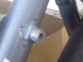

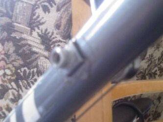

Couple of pictures of the boss, but my phone is pretty poor. Are you looking for anything particular? The left hand shifter fits fine, it's just the right.

It is impossible to see clearly from the photo, with vintage stuff there were indeed all sorts but it doesn't look a million miles from the "standard" Shimano/Campag one attached below or does it? If it looks like the one in the photo at the bottom then you will have to stick with vintage French shifters I am afraid. One other potential issue indicated by your Huret shifter, being French, is some as late as 80's need different threads which the typical Shimano/Campag bolts won't fit (but you might be able to use existing bolts). Is the frame French too? Separately can you work out, since left side fits the right side doesn't, what is causing the problem on the right?
Yes, it does look like the one in the photo, in that it doesn't have any "flats" on the sides (which the boss in the diagram does. I'm after a pair of Simplex LJ shifters, so I'm hopeful they will fit.
It's a 1989 Peugeot but the threads don't appear to be the problem, as (without the lever) I can screw the bolt all the way in. I now think the problem is the lack of flats on the boss, which mean the lever doesn't sit far enough down the boss.
