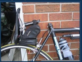

Be careful how you tighten a carbon post

pk thanks for the pic,I always use a torque wrench on my road bike carbon post,but at the same time I tend to nick up small turns at a time

It's just a stick to hold the saddle. The broken post in PK99's picture is not clamp related because it's well above the clamp.
