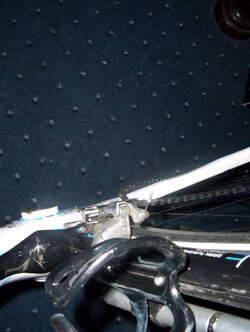

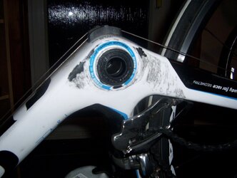

My chain flew off the small ring and jammed between it and my frame damaging the carbon frame (not sure how bad )now im not a bike mechanic but on inspection it was obvious the derailer hadnt been set correctly.
The bikes only 5 weeks old and i think whats happened is the cable has maybe stretched a little bit allowing the derailer to move closer to the frame(if it had been set up correctly this would not be possible).
Im not a happy chappy and would like opinions on what I should do next as i dont want a frame thats been compromised ?

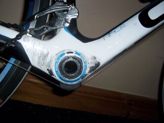

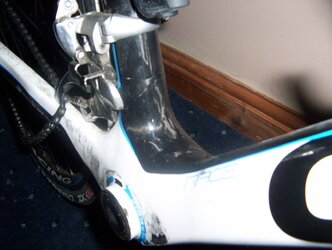

Took a few pics to show the damage and will try to upload.
You cant really see but the derailer is nearly touching down tube and there was only going to be one outcome here sadly.

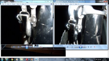

Yep limit screw not set right(see pic)one on left how it was,one on right after I sorted it.
Note how the derailer arm is parralel to downtube when set correctly.

I'm having difficulty understanding how you could do all that damage just from dropping the chain once. There's damage in places that wouldn't normally get damaged from a dropped chain.
As for preventing the chain dropping off again (as well as setting up the limit screw properly) then the best solution IMO is the Token chain catcher (same as the K-Edge, but much cheaper). Only you'd need to get a braze-on front mech and mount it to a band on adapter for it to work with your frame. As far as I'm aware this is the only kind of solution that will work with odd-shaped carbon tubes.
