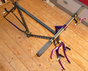

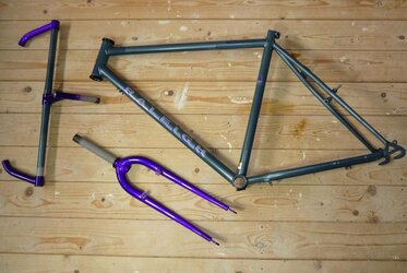

Now all stripped, cleaned and ready for the rebuild

The Sturmey Archer crankset recommends a 113mm BB. The one that came off was 118mm running a 170mm triple crank. The Sturmey is a 170mm crank with a dished chainring and guard.
The stays are doglegged so hoping there won't be a problem. Will find out tomorrow when they arrive.
This is all new to me so there's gonna be a bit of trial and error I suppose.

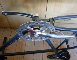

This is the crankset. http://cgi.ebay.co.u...e=STRK:MEWNX:blush:T

New crank and BB seem fine, plenty of chainstay clearance.
Chainline measures 47mm, which is about right I think
