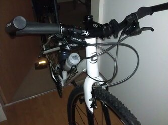

Ok so i flipped the stem of my new hybrid but now the front wheel rim rubs the brake pad. Looks like the brake cable is quite severely angled . The shop reckons the outer cable would need shortening and then could be too short later if i wanted to flip back up or change stems.
How frustrating!! I thought bikes were easier than this, i mean people must fark around with their cockpits all the time, right?
Any advice?

Outers only cost a couple of quid, if it does need doing, although I'd be surprised if flipping the stem moved the bars that much. What bike is it?

Cannondale quick... The stem when flipped is parallel to the ground, its prob a 15 degree stem. Be a shame if i had to get new outer as the stock ones are silver colour coordinated!

Pic
Norm
Nice bike. :thumbsup:
The angle that the cable goes into the brakes does look extreme, but then it looks like your levers are angled down quite a bit.
It looks like there is enough spare there to move the brake lever up by about 10cm, and you certainly wouldn't get that sort of change from flipping the stem.
Did you take pix before making the change? Have you got the cable routed the same way that it was previously? It's not clear from the pic but it doesn't look like the noodle is located properly.
Finally, have you tried adjusting the tension in the brakes? My kids' bikes have V brakes and I have needed to adjust them fairly regularly.
It's surprising how much difference it makes. I flip the stems on my bikes and I wouldn't bother if the effect was subtle, since I prefer the look of an unflipped stem. Flipping not only raises the bars, it also brings them back slightly.
Here's a ColinJ-eye view of a front-end with a flipped stem. You can see that there was only just enough length in the front brake cable to manage it. In fact, I had to put a small cut in the bar tape to gain an extra few mm for the cable.
Not surprising to me, I've done the same on my Secteur and posted the benefits a few times.
However, looking at the subsequent picture, there is a lot of slack cable there so I think some of the issue is the way that the LBS has set up the bike. I'd guess there would be at least 20cm more cable on cyclists' bike than on yours.
Ah, but Stu's bike has v-brakes so the cable has to come in from the side, whereas mine are conventional dual-pivot callipers with cable entry from the top. I could really do with a couple of cm more cable length.
Hmm. I've just put Stu's picture in a photo-editor and blown it up. I think you could be right about the 'noodle' not being located properly.

Lol no, its default setting is on the rise. I fliped it so it was flat. Dont know what noodle rfers to!
At any rate, another crap job by a bike shop. I discovered the brake pads were too high on one side, too low the other. One side was stroking the tyre, the other was braking onto the wheel not the rim.
Think ive fixed it! Thanks all...

Ps stem flipped down to lower the front end so sportifying the ride.
Stu
Glad you've fixed it!
You can see the way a v-brake should look (and what the noodle is!) here.
