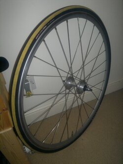

Below is the wheel in question. Apart from the flat tyre on it (my fault - I knew that innertube was dodgy), look ok?

1. It will be similar, but the effect of having a fixed gear is more than just riding in an equivalent gear with the ability to freewheel, but it will do as a rough approximation.
2. To see how much of a difference, use Sheldon's gear calculator, and from his article on singlespeed he says "Changing either sprocket size by one tooth is the equivalent of moving the axle 1/8" (4 mm)"
3. Rather than a lockring tool (C spanner?), I persuade the lockring into place using a flat bladed screwdriver in one of the grooves and tapping the end with a hammer.
wheres_my_beard
Norwich
1. It will be the same ratio. Do you spend most of your time in 2nd gear? How many teeth does the chain ring have?
2; The axle will actually come in closer to the bottom bracket by adding more teeth to the sprocket or chain ring (essentially shortening the chain). If Touche is right that will be by 4mm.
