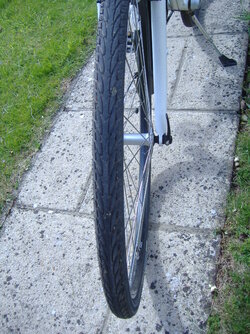

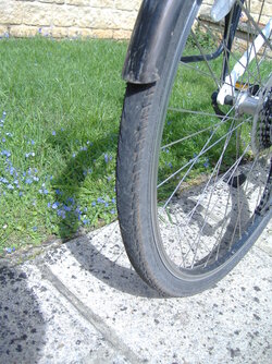

Hi all,
My Marin came with a set of "Maxxis Overdrive, 700 x 35c with Kevlar Inside Puncture Protection" and I've been very happy with them. After 2000 miles, and with me being a heavier rider who often commutes with a heavy set of panniers, the rear tyre is definitely starting to look like the tread is wearing (pics attached - hope they're clear enough - I've taken the front too for comparison).
My questions:
- How bad is the wear on the rear tyre? Am I nearing the end of it's life, or it is only 1/3rd of the way worn?
- If nearing the end of it's life, do most people simply replace the tyre, or should I swap it with the front tyre and wear them both?
Thanks,
MG

I reckon you can ride a little longer with that - maybe up to 2500 miles.
I'd order a replacement tyre anyway and have it ready for the changeover.
Don't put front on the rear to even out wear. Front tyre should always be in good condition as front tyre blowouts / punctures are far more dangerous than rear ones.

It still looks ok to me. As moodyman says though, get some spares in ready.
Are you getting lots of punctures? If not I wouldn't worry about it yet. Sheldon Brown has an extensive article here that may be of interest.
byegad
NE England
There's two schools of thought. One is wear it completely out, until the tread starts to show carcass.
The other is replace now.
The rear tyre will get more punctures in that state than when new and for me that's the decider. I'd rather ride than repair punctures.
Also in a fast corner you'll be cornering the rear tyre on a much smaller contact patch. If like me you like to let her rip down hill that would be another reason to change.
It depends on how much you like, or at least don't mind an extra puncture or two and how fast you ride.
You've not had too long out of that tyre my wide 37s got to around 6500 before the rear started to look like that. As it was the rear (and because of money :blush: ) I decided to go with the train of thought to wear it to the bone (so as to speak) and replace it when I started to get frequent p'tures (I did similar with my 25mm conti 4 season). If it had been the fron't I would have replaced it immediately. 2000 miles later I've had one p'ture (a drawing pin left conveniently for me :angry: ) other than the tyre is holding up fine and I'm in no hurry to replace it.

I would swap the front and back around TBH and run it a bit longer if you are not having any fairy visits.
My back tyre wears out like that as i commute with panniers as well.
