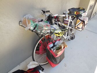

goldcoastjon
Mixte frames (from the FR for "mixed," as in mixed-use) are terrific load haulers, and even the lower-end ones like my 1972-ish Peugeot UO-18 mixte serve very well for urban riding/town bikes.
A true "mixte" frame has twin lateral tubes running from the head tube to the rear dropouts, or twin laterals from the rear dropouts that merge into one larger tube forward of the seat tube. This makes the frame laterally very stiff for carrying loads (tools, groceries, etc.).
Many big bike companies and smaller custom builders made these BITD and some still do. The French-made ones, in particular, tend to have longer top tubes relative to their seat tube heights.
If you are not riding long distances (20 miles or more) on this bike, you may do quite well with something like my "gas-pipe" Peugeot mixte or a similar Motobecane, Gitane, or Raleigh: install lighter wheels with alloy rims if you find one with steel rims that you want to upgrade. (I swapped out the wheels, crank set, brakes, and saddle on mine a decade ago.)
goldcoastjon
Here's a 2017 photo of my mixte, just back from the weekly Farmer's Market.
