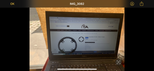

My bike mechanic gave me these details. I’m starting to wonder if he indeed measured correctly?
Does anyone know whether the Giant Entour+ 2020 has indeed a 104 mm or a 110 mm?
This is what he showed me on his computer =
T4tomo
Why are you doubting his info? You can always measure it yourself. 104 bcd seems to be common for a 38T single chainring on an ebike.
