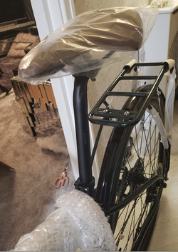

so to my amazement the bike arrived today
initial thoughts, it looks beautiful, trying to get it all set up and I ran into a major issue, the seat post is in the sky and won't go down any further because theres 2 threads for a bottle cage etc even with them screwed out it doesn't go down at all , the seat is in the sky
size S is 5ft - 5 ft 7 im well within the range yet the even the lowest setting my brother who is 5 10 couldnt sit on the seat lol..
also the light set I ordered front and back, they gave me 2 front lights only and they are not branded ribble but a different make
any suggestions?

I'll be the one that asks the most obvious question - to lower the seat, you are loosening the seat post collar and not just the bottle cage bolts aren't you?
As for the lights, I'd go back to Ribble a.s.a.p to get them to sort it. Having got a set with my ebike version of yours, I'm not sure they're worth the £40 quoted cost.

I'll ask the other obvious question; how are you (and your brother) determining the seat height you need?

yes the seat and post was not assembled so I had to do it which is easy as I've done it on my pervious bikes, yes the collar loosened only after realising it was not going to go down further I undone the bottle cage bolts which yielded in the same result , I will have to contact them about the lights it, is live chat with them my best bet?
well we just tried to sit on it, I'll admit I've not put the pedals on yet as I was going to do that last but even so, it is very high

Sorry for the obvious question, but it had to be asked. The seat post thing is an odd one - there's no way it should sit that high in the seae tube without going down any further which make me think there may be some form of blockage. I've got the large size bike and it came with a 400mm seatpost and is set up with about 200mm above the collar and 200mm in the seat tube as below
I've no experience of contacting them, but try an email first with pictures for them to look at and evaluate.
