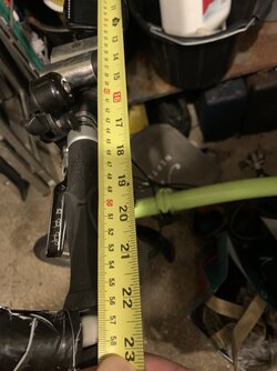

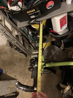

Ok. So my bars are 58cm (not including the plugs).
