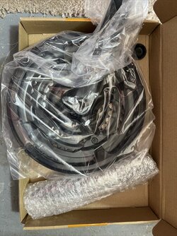

I’ve got a square taper brand new crankset like this https://www.ebay.co.uk/itm/38630484...ar=653839715374&widget_ver=artemis&media=COPY
£10 and it’s yours posted.

Great offer by @bikingdad90 .
You need to check the number of teeth on the big (outside) ring are the same otherwise you'll need to lengthen/ shorten your chain. If it's within a couple of teeth I wouldn't bother.

Good offer by bikingdad90. For the sake of a tenner the job's sorted. Just make sure the new chainset is compatible with the bottom bracket. It's not always a case of 'old one off, new one on'. It sounds like you know what you're doing so we'll assume you have the right tool to remove the cranks.

Thanks for the replies.
@bikingdad90 has saved the day.^_^
