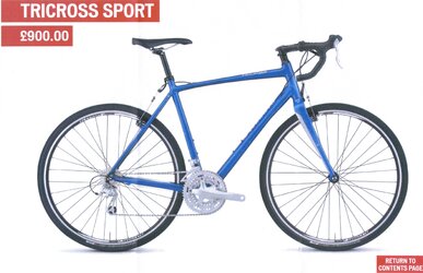

Yes, I'm a bit disappointed with this one. My 2010 tricross sport was "taken out " by a motorist and is costly to repair. I am eagerly awaiting the new tricross sport, but have been told by the LBS that it will be using sora gearing instead of tiagra. It will be a yucky blue colour and i'm now thinking maybe purchase from wiggle instead!!!!!!

forgot to mention...... there will be two versions. one with disk brakes and a steel fork, or normal brakes and alluminium fork.
Disc brake version = design FAIL as rear caliper is behind seat stay and not inside the rear triangle so mounting a rear rack is hopeless. Do the front forks have mounts for low loaders? Apart from this major fail and one question mark it seems ok.
I am convinced that the kids back in Taiwan that design 99% of bikes don't ride bikes everyday.
vernon
Harder than Ronnie Pickering
Meanwood, Leeds
It's hardly a fail. There's disc specific rear racks available. Front low loaders are not an essential fitting and I'd not lose sleep over the absence of front mounting bosses.
Crankarm
Nr Cambridge
Which are flawed in engineering terms creating a huge turning point on any bolt or cast dog leg on the rack just to avoid the brake caliper which could have easily been placed inside the rear triangle. So design FAIL if you want to mount a rack as most cyclists at some point do.
You say racks. I only know of the Topeak Super Tourist disc specific rack. What are the other makes?
It would only cost another couple of dollars, if that, for the frame builder to place the disc mount inside the rear triangle rather than behind the seat stay making it impossible to give a strong and robust rack mount.
The Boardman CX has got it right. Some one thought long and hard for 10 seconds about this issue and made the right decision.
