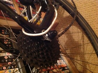

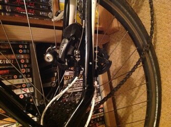

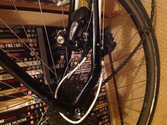

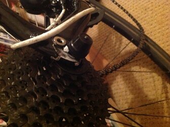

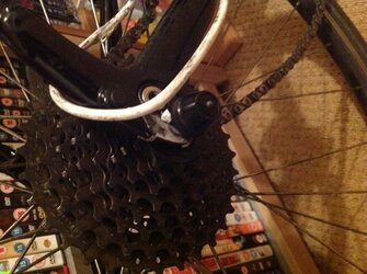

Was riding home from work this evening when my pedals locked, looked back and saw that my rear derailleur had snapped off.
On further inspection it appears the part of the frame that the derailleur was attached to has snapped.
I've only had the bike since 7th August 2012 from Evans. I just wandered if anyone can tell me where I stand with regards to a warranty claim?
In my opinion this is a manufacturers fault but would appreciate some opinions.
Please see pics
Thank you

Its the mech hanger they are designed to burst and be replaceable rather than writing off your frame, its comparatively cheap and easy to replace. I wouldn't have expected it to fail so early and if Evans care about their reputation, they'll replace it FOC after all you are still within 1 year. I've never dealt with Evans though.

I recently had to deal with this one on my own. It is very easy to repair, the hard part is identifying the correct hanger. I had to contact the bike manufacturer then order the part at LBS.
Keep a careful eye on hanger alignment when you get the bike back, the mech arm should be parallel to the "cogs" on the cassette.

Mech hangers (aka dropouts) are specifically designed to fracture if the rear mech gets a knock. A broken one just shows that the bike was working properly. I would guess that it is extremely unlikely for the hanger to break spontaneously, but I could be wrong.
