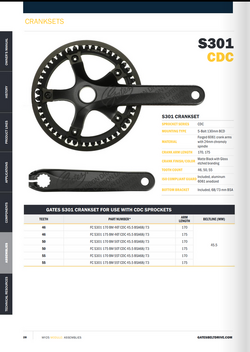

I got myself a new bike a recently, but I may already have an issue with the BB making clicky noises.
The crankset is a Gates CDC S301 (really a ProWheel) and the BB description says BSA 68/73.
A quick look online produces lots of results, so I'm at loss what to pick. Would any BB with the above description fit ?

I believe it's included. The 68/73 is it's max /mum width!
'mum' as in 'min' ?
So, 68mm refers to what is usually road bike width BB shell, 73mm is more on MTB.
You need a Shimano Hollowtech II BB - these are cups that screw on each side. You'll also need the tool to fit it (all are under £30).

68mm is the min width and 73 is the max width with spacers I assume ?
I already changed the BB on my previous bike but it was a Shimano so I just picked the same model. There is no brand on this one so I'd rather ask people who know.
