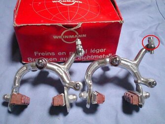

For caliper brakes in simple terms, you need to tighten the cable. Usually, there is a knurled adjuster which can be used to take up the small amounts of slack in the cable to compensate for normal wear on the pads without having to actually release and re-tension the cable. It will probably be fitted with a lock nut on which will have to be undone first and then tightened up again when finished. See the attached photo. I have put a red circle around the adjuster. Unscrew the small lock nut and screw the knurled adjuster out of the holder to lengthen the outer cable and effectively shorten the inner cable. That picture shows one type where where the adjuster is on the brake caliper. In some cases, you may find it on the brake lever (although the only example of a road bike with that I can think of are old French bikes). Weinmann500.jpg
