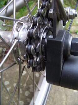

Crikey - this has turned into a 'maybe I should never have started this' exercise. Last week I received a 'spare' Brompton 2 -speed rear hub I'd bought off Ebay. It had an issue where it wouldn't freewheel properly if the alloy axle spacers were tightened - this turned out to be a poor repair to replace the freehub bearing. The bearing hadn't been pressed home fully and the circlip was missing. Fixed now, although it seems to have a bit of drag, so I may replace the bearing. Went about fitting the 10 speed sprockets off a Shimano HG500 11-25. My new chainring choice is 52T from Spa with 160mm cranks (my main reason to change was crank length). The 12 and 13 sprockets are shaped to fit engage with one another so I found my choice of 13/14/15 gearing wasn't possible and I had to accept 12/13/15 as my compromise. The 'spare' freehub was used to trial the fitment, and I had to file about 1.2mm off the inner edge (the part the inner sprocket butts against, to be able to fit the 3 sprockets and a snap ring I fabricated from a narrow section of a double-butted spoke. Despite being stainless rather than spring steel, I'm convinced it will never release unintentionally. The 12 sprocket was just touching the plastic of the tensioner, so I spaced it with a plastic spacer cut from a credit card as other Brompton owners have done. So far so good. A 103mm bb arrived today and gives the same chainline as the original crankset ...... I'm using the spa cranks with the chainring mounted in the middle. As the spa cranks also have the mounting for the granny ring (even if it's a double set) it presented a problem! The castings cleared everything ok for cycling, however if the rear triangle is folded under they clashed with the chainstay. So some 'engineering was done with a powerful! (unfortunately I don't have a Bridgeport mill or lathe). That done, the cranks were fitted successfully. I then turned to fitting the chain (I'd anticipated a possible issue) and indeed the chain is perilously close to the dropout - If I'd been able to go 13/14/15 it would have probably been ok. So the next job is to use the left alloy spacer nut off the 'spare' hub and reduce it by 1.5mm and add a spacing washer to the gearside to shift the wheel to the left a little. I'll re - dish the rear wheel a tad. So this mod hasn't been straight-forward at all. My B is a 2007 superlight, so I don't want to mess with the Ti rear triangle, I guess if a steel rear triangle is involved a small setting can increase the OLN dimension without fear of consequences. The new DR anchorage/cable mount arrived today from Condor (superb service) and I'm anticipating will be more straight forward. The B is such a compact fold that every part is precise and there isn't much scope for deviation - folk achieving multi-sprocket derailleurs must make some major changes?

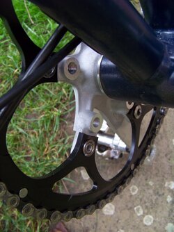

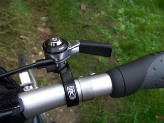

First ride today (only a few hundred yards to test) and some observations..... Firstly it works ok and finds all 3 gears. I had put the Sunrace shifter on the handlebar in a 'workstand position' and it became clear once I sat on the bike that it needed to be rotated on the bar a bit to be ideal. I'd also decided to put the shifter on the RHS instead of the left of the original Brompton 2 speed shifter (all my bikes have rear shifter on right!) so therefore had to use a new outer. The shifter needs a lot of angular movement to achieve the shifts (small diameter) but the benefit is that the lever position isn't so precise that it's difficult to achieve. I've noticed with this 'experiment'/change that the chainline measurement (ie, the position of chainring) is critical. With a RPM 103mm bb and Spa (Sugino) cranks the 'same as original Brompton' chainline of 44mm can be achieved, but required 'machining' to the granny ring mounts as described above - other makes of crank may vary. If the chainring is further out (and putting it closer would result in a clash when the rear triangle is folded under) the chain won't line up directly with the middle of the 3 sprockets, which is the ideal. That leads me to conclude if an outer chainring is fitted to achieve 2 chainrings as some folk have done (my chainring is on the inside of spider, just like current bromptons), that the chain must be very much out of line in the big ring unless an aftermarket 135 width rear triangle is used. It would be interesting to know what others have found, especially with up to 7 speed rear wheels!

Photo5 My new arrangement of 3 sprockets held with a DIY snap-ring made from a spoke

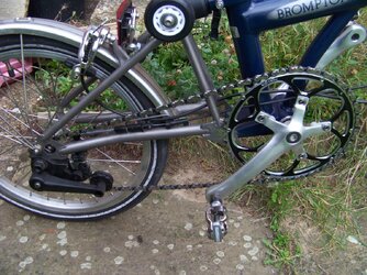

photo6 shows the new spa 160mm cranks and 52T chainring
Photo7 the inside of the cranks showing the 'filed to allow clearance' granny ring mounts. If a double chainset is used these are still there as part of the forging, but undrilled, so the task remains the same. If I had a lathe it would have been easier.
Photo8 The Sunrace friction shifter on RHS - this works very well but needed a slightly longer cable and outer.
