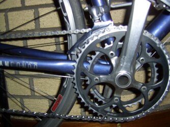

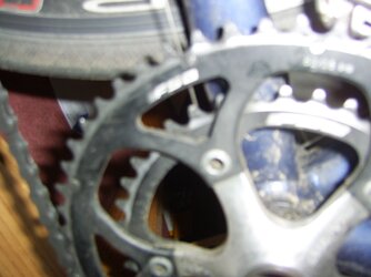

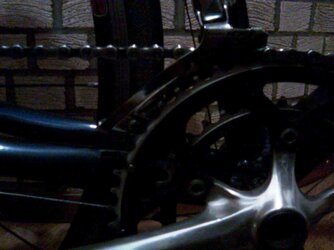

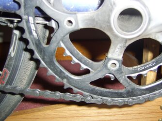

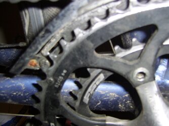

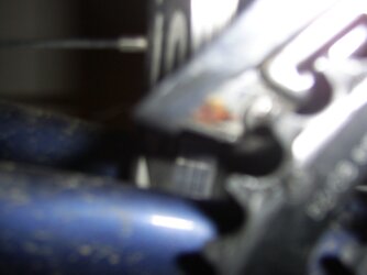

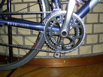

Chain Derailment, it seems to be happening a lot since I put a new chain/ cassette on as far as I know its the same chain set up but the cassette (previously a 12-25) was replaced with a 11-25. The chain now comes off at the cranks once a ride I think when I'm in the small (38t) chainring, shift down (up) I can never remember what is correct (from a large cog to a smaller cog) and then shift rapidly to the big (52t) chaining. Its probably hard to form an exact opinion but what do folk on the forum think, have I worn the front ring out a bit or is it just my bad shifting, compounded by rapidness and I should just tighten the limit screw since I have a smaller cassette.
And taken with Macro mode
when they are large they looked OK on the camera screen. I'll maybe try again with another camera (a bad workman blames his tools
