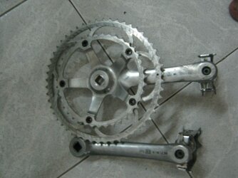

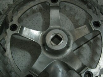

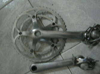

this is my crankset but I don't known is it Campagnolo crankset? if I mount Campagnolo record Bottom bracket 70X102 (my frame shell = 70) will they work?
click here to see it, please
http://www.mediafire.com/i/?x8579ftxyxfo2c1
http://www.mediafire.com/i/?drn6xchy3ybeele
http://www.mediafire.com/i/?rm0zqsfdgnvb2hx
thanks your reply

Unless the cranks are clearly marked with a European manufacturer's name like Campagnolo, Stronglight, TA, then my first guess would be that the square taper is more likely to be a JIS - so you would be better with a Shimano BB.
However with a 70mm BB shell you clearly have a bicycle with an Italian pedigree so if the cranks are original they might be ISO..... in which case a Campag BB will be a good choice, but you still need to get the spindle length right.
Do you have the old BB to check the spindle length?
Thanks you so much, my crank set have not mark (label) on it. Do you known it was producted by brand (Campagnolo, shimano...)?
have a nice day to you
From the back marks they are Campagnolo - I would hazard a guess at Athena from the 80's early 90's.
Ignore the makings on the crank arms please but these should be your cranks (click on the far right photo).
If so from a quick Google I believe they took a 111mm Iso BB spindle - can you try one out at a local bike shop?
