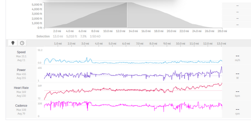

Do you have a smart turbo and an app like Zwift that has Ventoux, such as Zwift's Ven Top?
Given the odd virtual climb I've done of this monster, I suspect it's going to take you approx 2+ hours at endurance pace.
Any local hills of similar ~8% gradient you can climb and descend for 2+ hours and see how you do with current gearing?
I can't be certain, but I think this Ven Top ride was 100% trainer difficulty with 34/50 rings and 11-34 when I was approx 78-80Kg back in Xmas '20, so ~2.5W/Kg and a z2 endurance effort.
