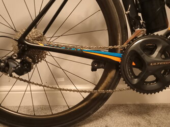

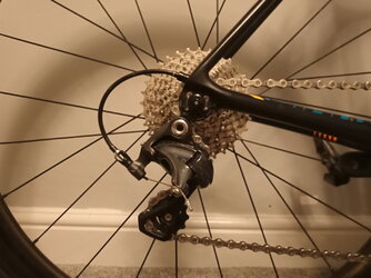

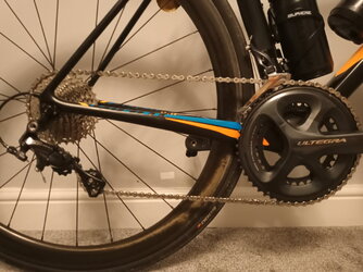

Alright, so I've put this bike together from scratch with used parts. Did an 80k ride on Saturday and something isn't entirely right with the rear derailleur, I think.
Based on below, does this look/sound right to you?
Biggie-small, line through axle and pulleys not 90° to the ground but not miles off:

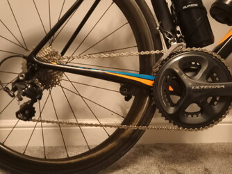

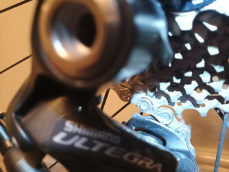

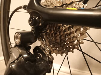

Small-biggie, guide pulley very close to big sprocket (2-3mm) but shifting fine up and down:

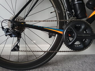

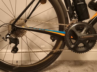

Cross-chain positions (if you want to see them):
Chainring: 50/34
Cassette: 11-32
Chainstay length: 16 inches
Chain length: 54 links
Short cage derailleur, according to the manual,suitable up to 33t sprocket. 'B' adjustment screw in max position.
Any advice welcome.
