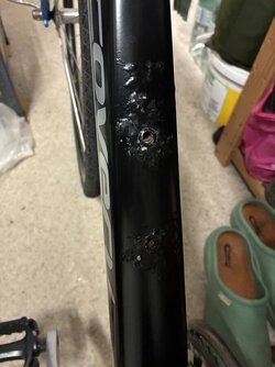

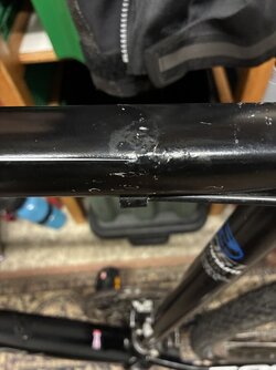

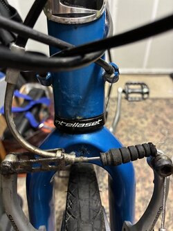

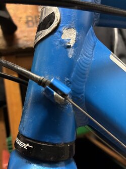

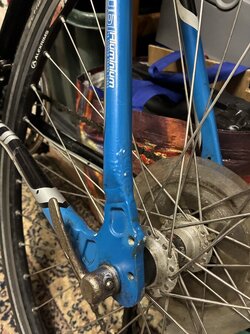

Right, it's home and I'm back from a bike rally :smile:
I've given it a wash and lubed everything that moves, the gears run nicely, it need new brake cables and blocks, but otherwise looks OK for my intended use.
However, I've not experienced an aluminium bike before, there's some patches of corrosion, that under the bottle cage obviously caused by galvanic corrosion, but also aluminium oxide showing near the steering tube and some other bubbles. As it's a short term project, maybe a 2 year bike I was thinking of just sanding back the corrosion and applying a few dabs of paint, won't be pretty, but assume it wan't fall apart?
None of those spots look too bad. Just sand them to clear all the corrosion (go a little bit wider than the surface marks you see) and if it does not look as if it's penetrated the alloy you should be fine.
