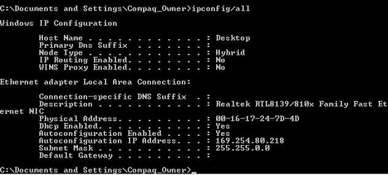

windows xp can be fickle when it comes to dhcp and getting it to change its config always works best in dos ipconfig/renew, if i was you as you work from home i would take some time to set up static ips on your lan as this takes away the dhcp function and gives each machine connected its own ip and the same one each time that way it will never call up the microsoft preset ip ranges if any of the equipment has a blip and don't communicate properly.
there should be on the base of your router (depending how old it is) a gateway ip (the routers preset ip) entering this into your browsers address bar will let you into your routers setting where you can change all the settings i.e. the dhcp setting so you can set up static ip's then you will have to set it up on your machine also through the control panel>network connections> properties>(tcp/ip) properties, its pretty straight forward as in you copy the mac addy, dns and ip you want in to each set of config options on/from/to the router and pc you should also find a better connection speed as doing this takes some of the work load from the router in deciphering which machine its talking to in effect.
