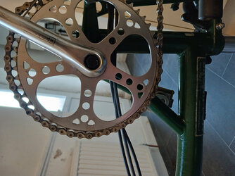

Perhaps the OP needs to contact someone like Brilliant Bikes to see if they've come across something like this previously. The chainring doesn't look outrageously worn, but even if it was, if the pitch of a new chain was correct, it ought to fit round the chainring even if it ran rough or jumped under load. Back in the days of 5 speed derailleurs I've run chains with chainwheels with far worse appearance than the OP's pics.

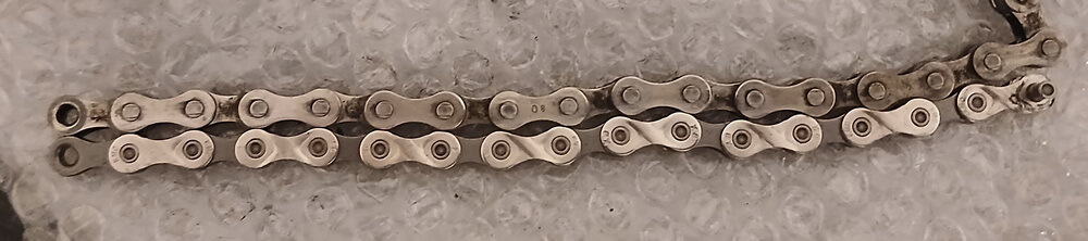

In any case, the pitch ought to be the same, it's the width that changed, and that ought to either fit, or not. It's baffling.
Is there any remote and bizarre possibility that the new chain is some kind of knock -off made to inaccurate standards? It sounds unlikely, but who knows nowadays.
These points are why I was kind of tentative with my chain "stretch" theory. You should be able to fit a new chain onto a worn chainring, even if (as you say) it starts jumping when you put it under load.
If @MontyVeda has a chain checker it may be worth seeing what it has to say about the 2 chains. Maybe it's very cold in Lancaster and the new one has contracted;)

That's what i was thinking... a new chain should fit onto a worn ring, but this one clearly doesn't.
I do have a chain checker but i haven't checked the new or old chains with it yet.

I was going to put the old chain back on but whilst most of the 50t chainring looks OK, two sections are clearly worn...
...which explains why in this picture...
...some of the chain is seated quite neatly and the remaining 'good' teeth won't let it sit at all.
The current worst case scenario is I have to grind down the sprocket I've got by about half a mm. either side.
