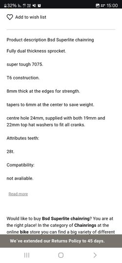

The key thing is the thickness of the sprocket that you have fitted. It could be (and probably is) 3/32" or 1/8" and the chain should be appropriately sized.

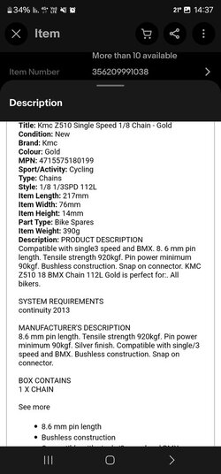

I tried to figure out from the info online but I'm still not sure..
Is this pictures have the thickness info?

The chain in your pics above is a KMC 1/8" chain
Style: 1/8 1/3SPD 112L
1/8 = 1/8"
1/3SPD = Single speed or 3 speed (hub gear)
112L = 112 links.
That should be fine. It will fit regardless of whether you have 1/8" or 3/32" sprocket
