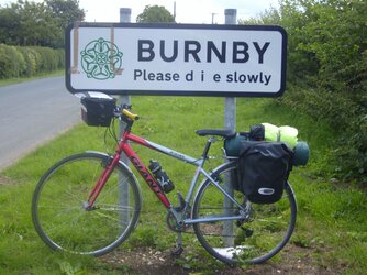

I had a camping weekend away last year, on my Giant FCR - it's a flatbarred roadbike, with rack fitted. I carried two panniers (don't know the litre volume, but they aren't big ones), and got tent, sleeping bag and other kit in the panniers, and my bedroll on the top of the rack. Here it is.
As you can see, it's all on the rear, and it handled ok, if a little heavy uphill... I worried a little about the weight on the bike, as it's relatively light, but it handled it no trouble.
I wold suggest you look at the camping kit you have, and see if you think you can get it in the bags you have. My tent is pretty small of course, technically 2 man I think, but that would be very cosy indeed.
If it's all too big, then you can think about bigger bags, smaller equipment, or both. Of course, I was alone, so only had stuff for one person and a weekend to carry. Can the lad carry anything? Not suggesting you load him too much, but even if he could take bags with the sleepng bags in, it would free up room on your bike.
Also, if you're used to camping by car, you might find there's a lot you'd normally consider essential that you don't want to lug on the bike.... Will you want to cook, for example, or find sites where you can eat nearby?
Other people will have lots of specific kit suggestions...
