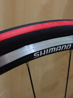

Tomba
Lawrence, the wear indicator is on the opposite side from the valve.
This is the front wheel after maybe a couple of thousand miles.

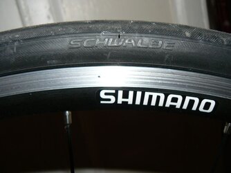

Thanks Tomba, just gave the wheels a bit of a clean and found it...
Slightly concave each side of the indicator but looks OK....
That's saved me a few quid this month then!
