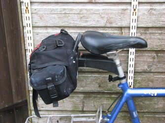

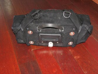

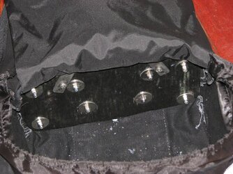

Here's what I did with my Carradice Barley bag to attach it to the seatpost using the adapter shown in PpPete's post above :
