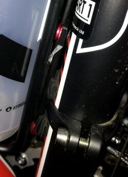

Use some rubber to build up a squishy wedge either side of your front mech bracket. I've attached a picture of how I did mine, using spare bits of rubber from fitting kits for other bike bits (lights, bell, etc). You can see that the bottle bracket is tightened down using the two red bolts onto the rubber, and not onto the front mech clamp. It's solid, and it doesn't look too untidy either.
When you're fitting your garmin sensor, make sure you offer it up in every configuration you can think of before applying the cable ties. I did the "sizing up" on mine with a cuppa. It wasn't hard to do, but it'll be fiddly if you don't get it all just right before pulling it all tight.
+1
I used some rubber grommets to lift the holder away from the frame, the mounting bolts pass through them so they wont fall out whilst making final adjustments. Slightly smaller (than I used) would have fitted better but they worked OK. I used 9mm which can also be used to adapt rim valve holes from schrader to presta.
