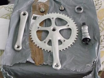

Bargain. And as a 107mm JIS taper is a 'standard' size and you can source a BB, I see no reason not to go for it.
D
Deleted member 1258
Thanks, that was what I was thinking, they've replied to my E-Mail saying its a standard BB so it definitely looks like its a bargain.
D
Deleted member 1258
I've now ordered one, plus a shimano bb and tool.
D
Deleted member 1258
Chainset and bb arrived this morning, ordered about 11:30 Thursday night, well done to On One and Chain Reaction Cycles. I've fitted my spare 46 tooth chain ring and put it away till I've got the other stuff I need.
