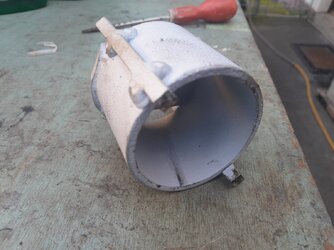

Having done it a couple of times I knocked up this tool to unscrew the ballcup.
