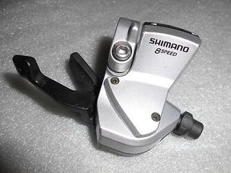

i assume this shifter will work, listed as an 8 speed shifter i would like to mate to a 2300 rear mech and 8 speed cassette ?
Yes, assuming you are using flat bars.
