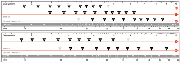

MTBs have simply had the top end of gears removed. My old '90s MTB had a triple with pretty high top gears. Modern MTBs just don't bother with those, and as the comments above suggest, it's a gap for "gravel" setups too.
The gap it leaves is for setups where you want a really large gear range, which doubles, at least as currently constituted, can't deliver.
Spa cover this gap in a similar way to my own setup with 9 speed Sora; the double options either require big cassette steps (11-40 9 speed) or low top gears (40 tooth), which is why a triple is attractive. "Gravel" groupsets just don't have low enough gears, unless the gravel isn't too steep IMO.

Thinking about this out today on my Croix de Fer (with a triple) and the triple is very useful eg approaching a junction and you just drop one on the front. Riding today in Flatlandia but eg longish slight incline and the narrower rear allows drop a rear gear just to ease the effort a bit.
Not a massive requirement for my ride today but on a longer tour in hillier places carrying full camping gear and it's much more important (to me anyway).
