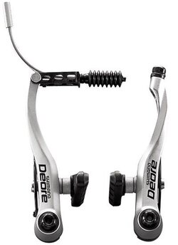

There is no difference between front or back regarding arms or pads. But if one of the arms or pads is missing you do need to be sure they send the other one because "left" and "right" are not the same in both cases.
the easiest way of knowing which one you are short of is to look at the top of the brake callipers. One will have a screw (adjuster) for clamping down on the brake cable, and the other will have that clip thingie (sorry lack of terminology again - can't think but is the one of the left of the image I have uploaded) for holding onto the end of the brake cable outer...
Currently sitting looking at 2 pairs that I know I took off the front & rear of my OH mtb when I upgraded his brake callipers and there is no left/right or front/back markings on any of them, and there are 2 different models here
