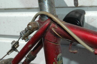

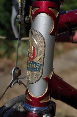

I picked up this Viking Conquest today. I am hoping to clean it up and get it rideable again.
It is in original condition , one owner from new. It is from the original Viking company from Wolverhampton, I think from their glory days of the 60's.
Here are some pictures of it before I washed it and started cleaning it.

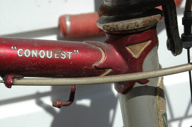

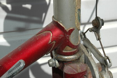

After a bit of a clean.
I have not seen this make of steel tubing before. I think it is I C L. It has gold lined Nervex lugs.

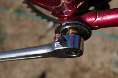

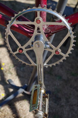

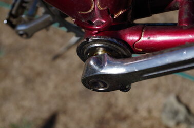

I've been out in the garden in the shade this afternoon cleaning it up . I have been de rusting the cranks and rear mech. The cranks are coming up well . The rust scabs can be scraped off with a flat bladed screwdriver after brushing on the gel . The rear mech is cleaning up but some of the chrome has come off . It has disc idlers .
I had a go at polishing the paint and I am really impressed by the finish . The clear lacquer is as good as that on my 80's Raleigh Clubman.

There are some bits I really like which I am discovering whilst cleaning it up . I like the V logo on the bolts . The cotter pins are usual or I haven't seen anything like them before . They are bullet shaped ! They remind me of the 60's TV series "The Lone Ranger". He handed out silver bullets !
I had a look on the back of the front brake caliper hoping to find a date stamp but there wasn't one ! :sad:

T4tomo
I think the derailleur has Allvit on it
Allvit was a Huret range derailleur. there is an example shown on https://www.disraeligears.co.uk/site/derailleur_brands_a_to_r.html but not your one.
I have no idea which model btw, I was just referencing VCL vs ICl tubing with that link, its the right era, but spec will no doubt vary between years.
