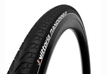

2/: Suggestions for a sensibly priced, puncture friendly, general purpose, generally dry-use tyre with semi aggressive tread (Something like below tread wise as an example)…..
Thanks in advance 🙏

The Randonneur has been my tyre of choice for some time, not quite as hard wearing as they were but excellent puncture resistance and sounds like the 32mm size is just what you are looking for. Don't throw them away when the red layer starts to show, still at least another 1000 miles of life to go.
I have to question your description of semi-aggressive though, IMO they are best described as semi-slick with the continuous centre band and grooves to the sides rather than knobbles or tread.
