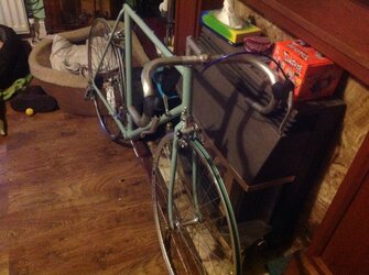

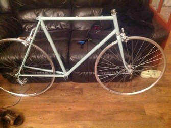

Here is the start of the rebuild. Need to get it finished before Xmas.
Currently spent
Frame £25
Respray £30
531 decal £5
Weiman xr18 front wheel £10
Campagnolo mexico 68 rear wheel free
New dual pivot brakes £45
Campagnolo crank £31
Campagnolo rear mech £10
Brake and gear inner/outer £10
Inner tubes £5
New tyres £18
All other stuff as original bike
Total £189
Still need handlebar tape
Didn't need to get new crank and brakes, just wanted to make it extra special as it's for my son.
This restoration business is expensive.
Will post pictures as and when it's finished.

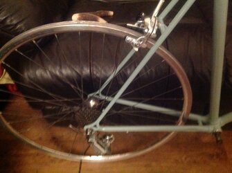

Xmas cheer has just left my household. Some noob mistakes and a little bad luck.
Front derallieur knackered. Wasn't until I tried to get it adjusting that one of the screws broke :-(.
No problem, had a spare derallieur so off I went, put it on but could I get the damn thing to change from the inner ring.
And here is the noob mistake.... Campy crank doesn't fit on the spindle properly so no amount of adjusting was ever going to get it done. Gutted but honestly didn't know there were differences in tapers etc.
Have the original crank ( minus left crank as was already stripped). Will need to run and try and get a spare left arm, luckily have a recycle place that is open on Saturday.

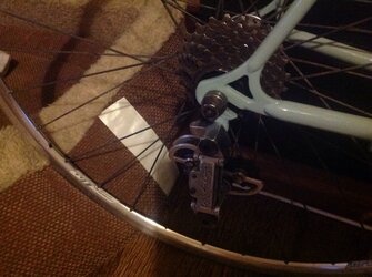

Good news is rear mech is all up and running so still hopeful that it will be finished for Xmas.

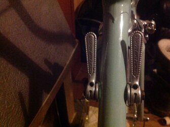

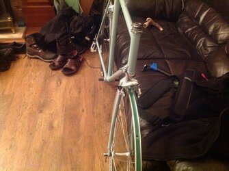

One of the perks of the 83 rapide was that it already had recessed nuts for the brakes so got lucky.
The stem was just polished with the much beloved auto sol.
I cheated on the seat post and got a new one.
Here's the latest picture with original crank back in (a little lovesick for that campy crank).
I'm still pretty pleased for my first full restoration.
