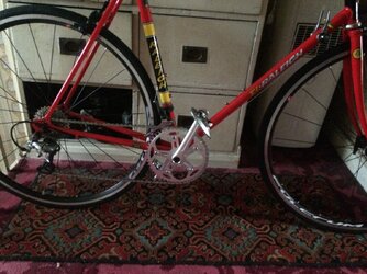

I am a bit fed up with the running costs of the 10 speed, it came with a Shimano chainset and a BB30 bb so needs an adaptor and it gulps bearings
So I have been contemplating switching over to the Raleigh.
Currently set up as 1x8 (48/11-28), after all if you are going to run a retro bike why not have retro bike gear ratios, apart from a slightly higher top gear the ratio spread is pretty close to 42/53&14-24, actually I will switch to a double I just need a longer BB.
