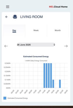

I’ve had one for 15 years. Use it for heating 9 months of the year and for the first, and probably only, time this year it was on for 8 hours cooling yesterday.
it used 1.4 Kw
