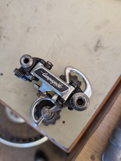

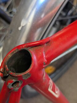

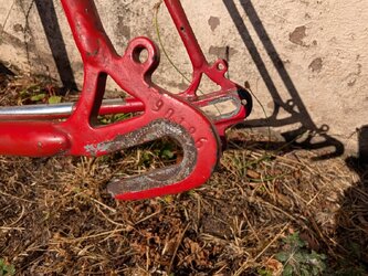

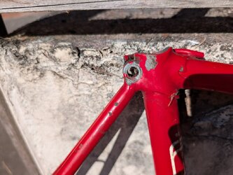

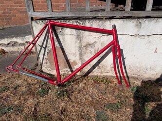

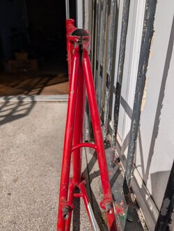

Another Enviroability donation. It came in as a complete bike (with horrible steel rims on Campagnolo hubs EDIT: hubs found to be Maillard, on closer inspection). I've stripped it and found some pretty nice parts on it, including a Super Record rear derailleur and a complete set of Mafac cantis with Modolo levers. I have no idea what make the frame is - the only decal on it says it's been resprayed - but there are some cool design features like the skinny rear brake bridge and the way the seatstays meet the seat tube. I don't think it's 531 as the seatpost is 26.4mm, but it could be plain gauge tubing. The dropouts are Zeus and there's a serial number on the non drive side rear dropout, but no other identifiers. I might rescue this one. Any ideas what it might be?

With a long frame number like that, it'll be identifiable somehow - and touring frames were always niche, so not too many builders to reasearch. 26.8 is a plain gauge 531 seat tube but sometimes the rest of the frame was 531ST.
There's no hanger for cantis on that brake bridge, which is strange.
Is all the threading ISO?

There was a bit of a hanger left on the cable before I stripped it, but the way the cable is routed means a hanger is not actually necessary. I think the threads are ISO. I still don't know whether to take it home with me: I really don't need it but I can't see it selling at Enviroability and I can't scrap it!

Stolen?
"A bike with frame number 90186 was reported as stolen to North Yorkshire Police."
https://www.bikeregister.com/bike-checker
Second result on searching for the frame number alone.
Worth checking with North Yorkshire Police?
classic33
Leg End Member
I will check, but to be honest I'd be very surprised if it was this one!
You'd not be the only one.
Search was, 90186 bicycle frame number. And that was the second hit.
They might have information on the frame though. If it's too late to return it.

I wondered about that. The rear drive side dropout is similar to French frames I've owned in the past. Also, the hubs are Maillard and the stem is Mavic.
That was why I asked about threading, although the better and later French frames were ISO. It doesn't seem to be a Gitane, Motobecane, or Pug number, and I don't think Mercier made touring bikes.

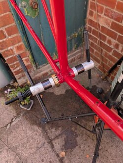

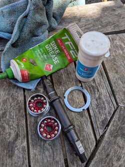

I know I've said it before, but I love the way old bike bits are so serviceable. This is the original bottom bracket, cleaned up and rebuilt with new grease and bearings (total cost approximately bugger-all) and good for another lifetime. I know you can fit new bearings to sealed bottom bracket units, but it's much more work.
