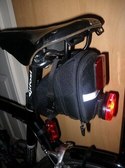

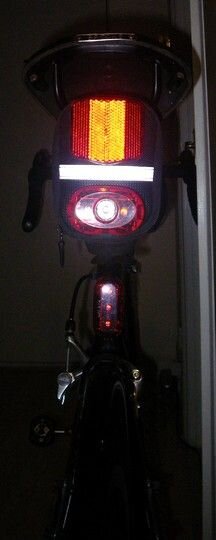

zigzag
i had no seatpost space available for rear light, but attached one where the seat stays join above the brake caliper. i've attached another light to the saddle bag loop and also removed "topeak" badge, poked a hole and screwed large reflector for added visibility.
zigzag
Beware: I used one of these for my back light on the last FNRttC and on rough road surfaces the light flew off three times! A strategically placed elastic band solved the problem.
oh yes. i always fold a piece of inner tube around the loop - makes a very tight and secure fit.
[attachment=5812:blush:MGP0758.JPG] [attachment=5811:blush:MGP0762_cr.jpg]
That looks wicked.
