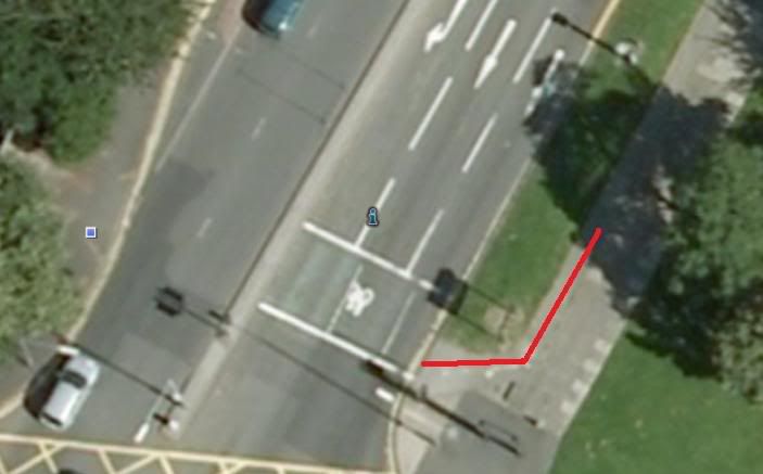

You also get ridiculous ones like this-
http://i141.photobucket.com/albums/r70/jub_jub_bucket/EdgbastonASL.jpg
The red line shows the path of the cycle lane, which spits cyclists out right at the front of the ASL. If you can get there safely (which is rare) then you have to walk th bike backwards to get into the box properly.
It's a mess, and needs sorting out.
