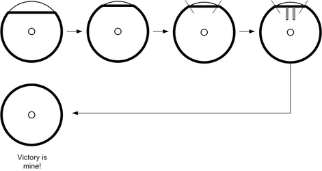

So what is the best way of getting these new tyre on without giving myself a hernia!!? :blink:
No idea if this is the "best way" but it worked for me:
Once you have two thirds of the tyre on the rim, hold the rim so that the lose portion of the tyre is at the top.
Use two hands to roll as much of the remaining tyre on to the rim as possible. You'll get to a point where you can't roll the remaining tyre over the top of the rim but if you let go the tyre will roll off. The portion of the tyre that is not on the rim at this point will be very tight. Now try to clamp the tyre in place using a single hand, and with the other free hand take a cable tie and use it to clamp the tyre in position just below where it is comming off the rim. You'll need to do the cable tie very tight. With the tyre clamped in position use a pair of tyre leavers to roll the remaining tyre over the top of the rim. Remove cable tie before fully inflating.
Nearly drove me nuts but this is how I defeated them...
Howard
Howard, look at the video below. This is how I did it. No tyre levers either! :becool::biggrin:
Yes, just watched it! Feel kind vindicated on the use of cable ties - and will try and do it without leavers next time...
