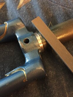

First I had to file down the crown race seat from 26.7 mm to 26.4 mm. No problemo.

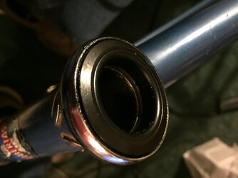

Pressing the lower cup in:

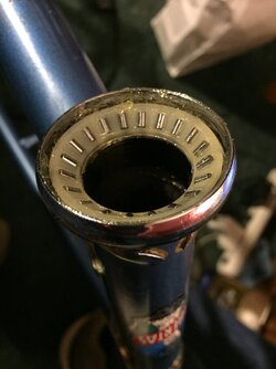

The bottom race holds the needle bearings:

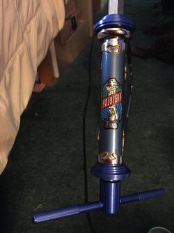

Steerer tube goes in here:
Fits perfectly, whaddya know?

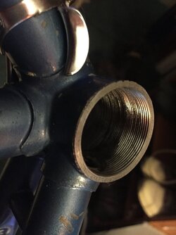

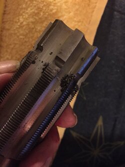

Trying to fit a bottom bracket, I ran into some resistance putting in the fixed cup side, so I ordered some chaser taps from Japan, and managed to get the fixed cup side cleaned up. I don't believe this frame was ever built up before, as that revealed the BB needed facing, too.
So, I took it to Beanie's Bike Shop in Los Alamos for more chasing and facing. Ready to go:
